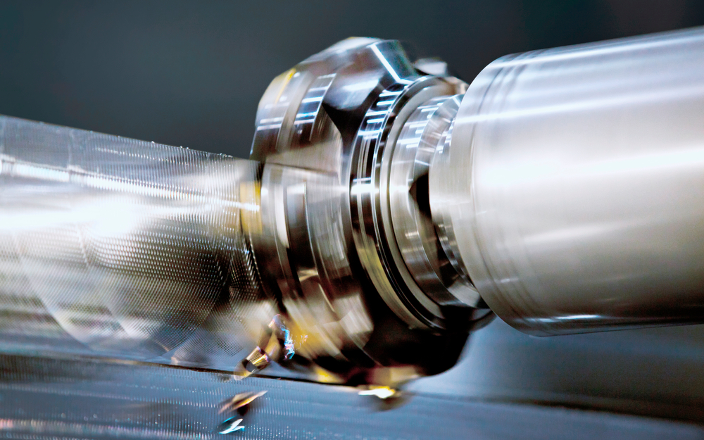

Themed image Productive horizontal
The horizontal boring machines from DMG MORI Precision Boring are designed for the precision machining of large, heavy workpieces.
