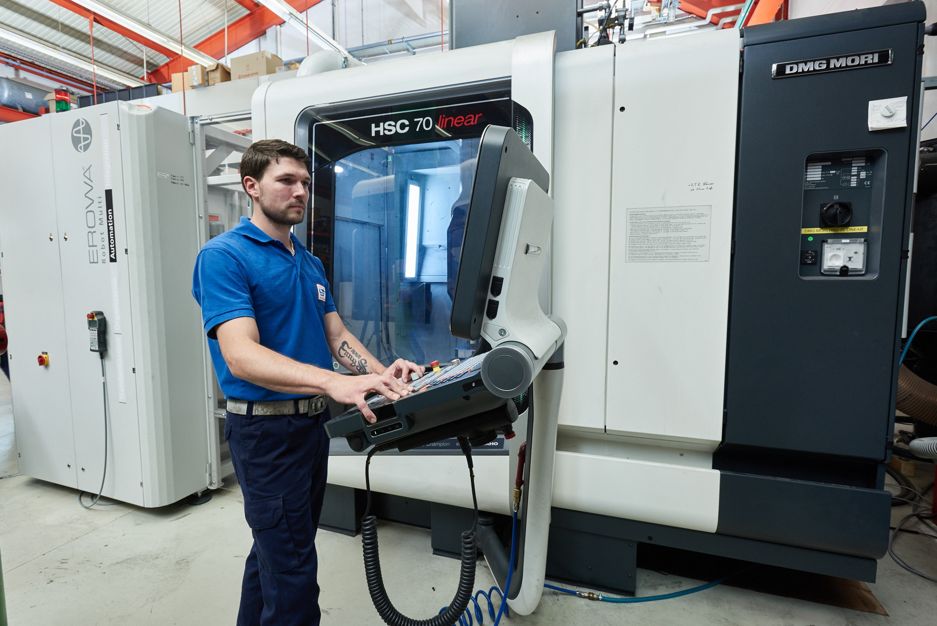

DMG MORI prepared the HSC 70 linear for use with automation solutions. Werkzeugbau Erz uses a robotic system to handle 9 pallets and 90 electrodes.

The spindle of the HSC 70 linear operates at a speed of 40,000 rpm, which enables the machining of maximum surface qualities with the smallest possible milling tool diameters.
