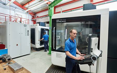

Installation of the first machine for high-speed machining at Werkzeugbau Erz in 2012 – the HSC 105 linear – was followed in 2014 by the HSC 70 linear, the second HSC model from DMG MORI.

DMG MORI prepared the HSC 70 linear for use with automation solutions. Werkzeugbau Erz uses a robotic system to handle 9 pallets and 90 electrodes.
