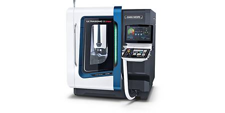

With a new look and improved performance across the board the new ULTRASONIC 20 linear 2nd generation impresses in demanding ultrasonic machining.
World premiere: ULTRASONIC 20 linear 2nd generation

Highly dynamic, long-term stable 5-axis machine concept – compact on 3.5
DMG MORI relies on the long-term stable gantry design for the ULTRASONIC 20 linear 2nd generation in order to meet the demands on precision for ultrasonic machining. Whereby the machine tool manufacturer was able to reduce the footprint to a compact 3.5 m². A duel drive in the Y-axis and the integral cooling concept that includes temperature monitoring of drives and spindles as well as the control cabinet and all media guarantee top precision and component accuracy. The linear scales from Magnescale are another example of the high-tech components used by DMG MORI here.
DMG MORI has increased the performance of the drives significantly in its latest development: by 47 percent in the A-axis, 27 percent in the C-axis and 34 percent in the Z-axis. The linear drives achieve maximum accelerations of > 1.2 g and a 50 m/min rapid traverse. With the very large swivel range in the A-axis of the work table of -15° to 130 ° and the fully integrated infinitely rotating 360 ° rotary axis – both with torque technology – the ULTRASONIC 20 linear 2nd generation is optimally equipped for highly flexible 5-axis simultaneous machining. The up to 1,500 rpm available as an option for the C-axis enables cylindrical mill-grind and mill-turn operations.
After its revision, the ULTRASONIC 20 linear 2nd generation is now also capable of handling larger tool diameters of up to Ø 50 mm. It has also been possible to increase the workpiece weight from 10 kg to 15 kg.
The basic machine is equipped in the standard version with a powerful 19 kW motor spindle, HSK-32 tool holder and 42,000 rpm. Higher speed requirements are met with an optional spindle that offers an impressive 60,000 rpm. An HSK-40 spindle, optionally with permanent grease lubrication, rounds off the offer in this segment.
DMG MORI’s modular concept allows very application-specific equipping of its machines, also in the case of the ULTRASONIC 20 linear 2nd generation. The machine is also available with a 1,500 rpm mill-turn table, for example, which expands complete machining to include milling, turning and grinding of rotational-symmetrical components in a single setup. In addition to the standard 24-fold tool changer with pick-up, the chain magazine is optionally available for 60 tools.
