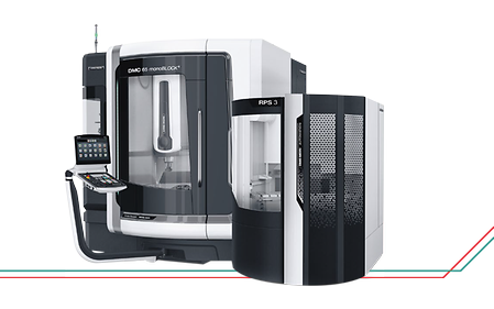

Machine integrated automation for smallest foot prints
DMC 65 monoBLOCK with RPS 3
Highlights RPS 3 / RPS 4 / RPS 5 / RPS 6 / RPS 7 / RPS 9 / RPS 12
  • Handling of workpieces up to ø 3,400 mm, a length of 1,650 m and a weight up to 10,000 kg
  • Reduction of auxiliary process time through loading and unloading during machining
  • Manless shifts for recurring workpieces through ring buffer with max. 12 pallets in the system
Rotary Pallet Storage with outstanding space saving and setup capacity
