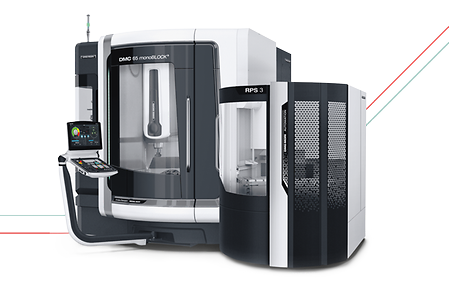

RPS
DMC 65 monoBLOCK with RS 3
  • Reduction of auxiliary process time through loading and unloading during machining
  • Manless shifts for recurring workpieces through ring buffer with up to 12 pallets in the system
