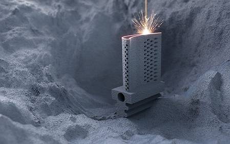

  • Highly complex components with function integration
  • Internal close-contoured cooling channels
  • Weight optimisation due to lattice and honeycomb structures as well as topology-optimised components
  • Simultaneous build-up of different designs
  • Functional prototypes made of series materials
Additive Manufacturing with a 300 x 300 x 300 mm (X / Y / Z) building volume
  • High precision building of 3D parts with dynamic adjustment of the focus diameter (70 µm - 200 µm) and layer thicknesses between 20 µm and 100 μm for maximum productivity
  • Application-specific fibre laser sources from 600 W as standard to 1 kW optional
  • Optimised shield gas volume flow for highest component quality with minimum Argon consumption < 72 l / hour
  • Open system: Individual adjustment of all machine settings and process parameters as well as unrestricted selection of the material supplier
  • End-to-end competence with integral process understanding from drawing to finished part: DMG MORI Process Chains for pre- and post-processing of additively built parts
